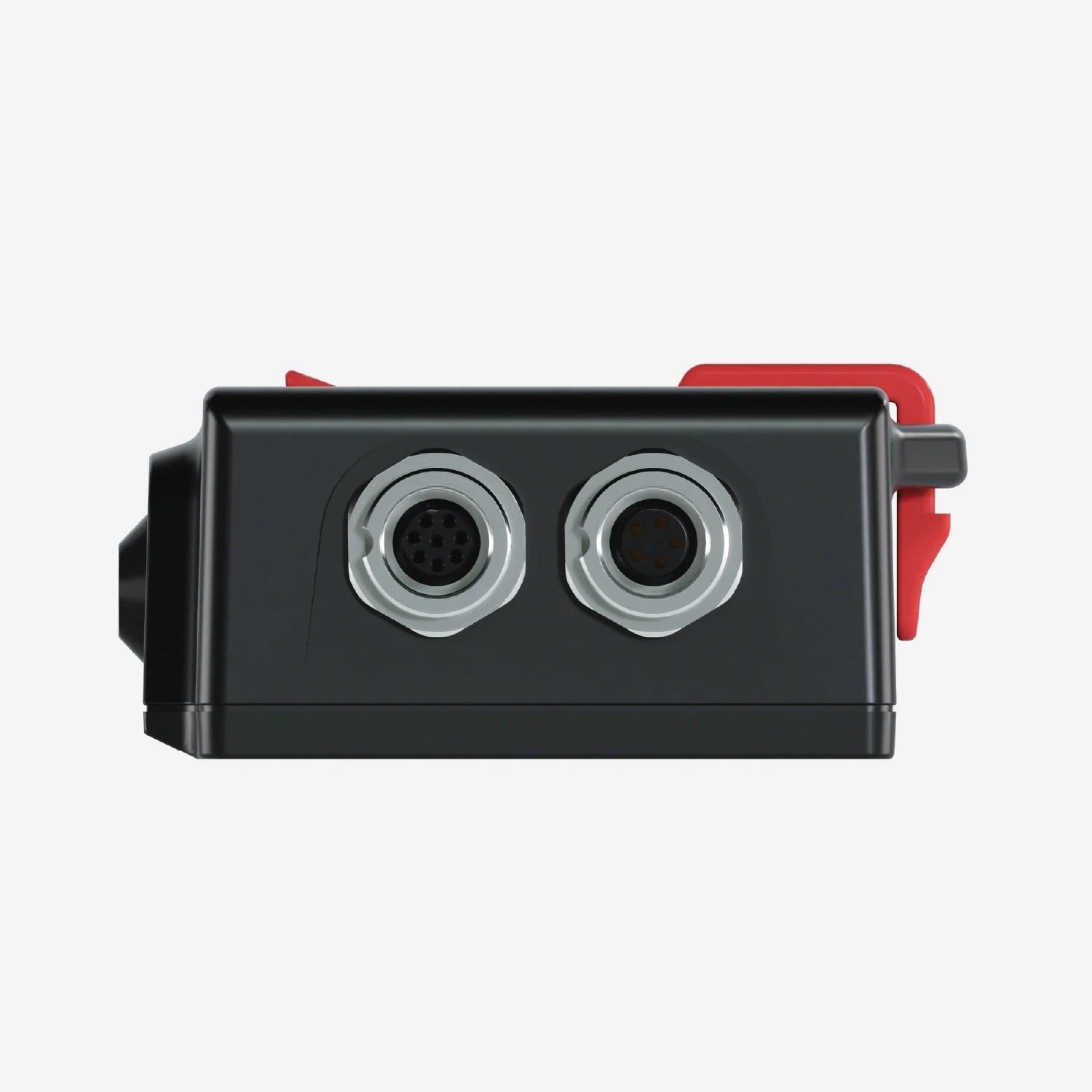

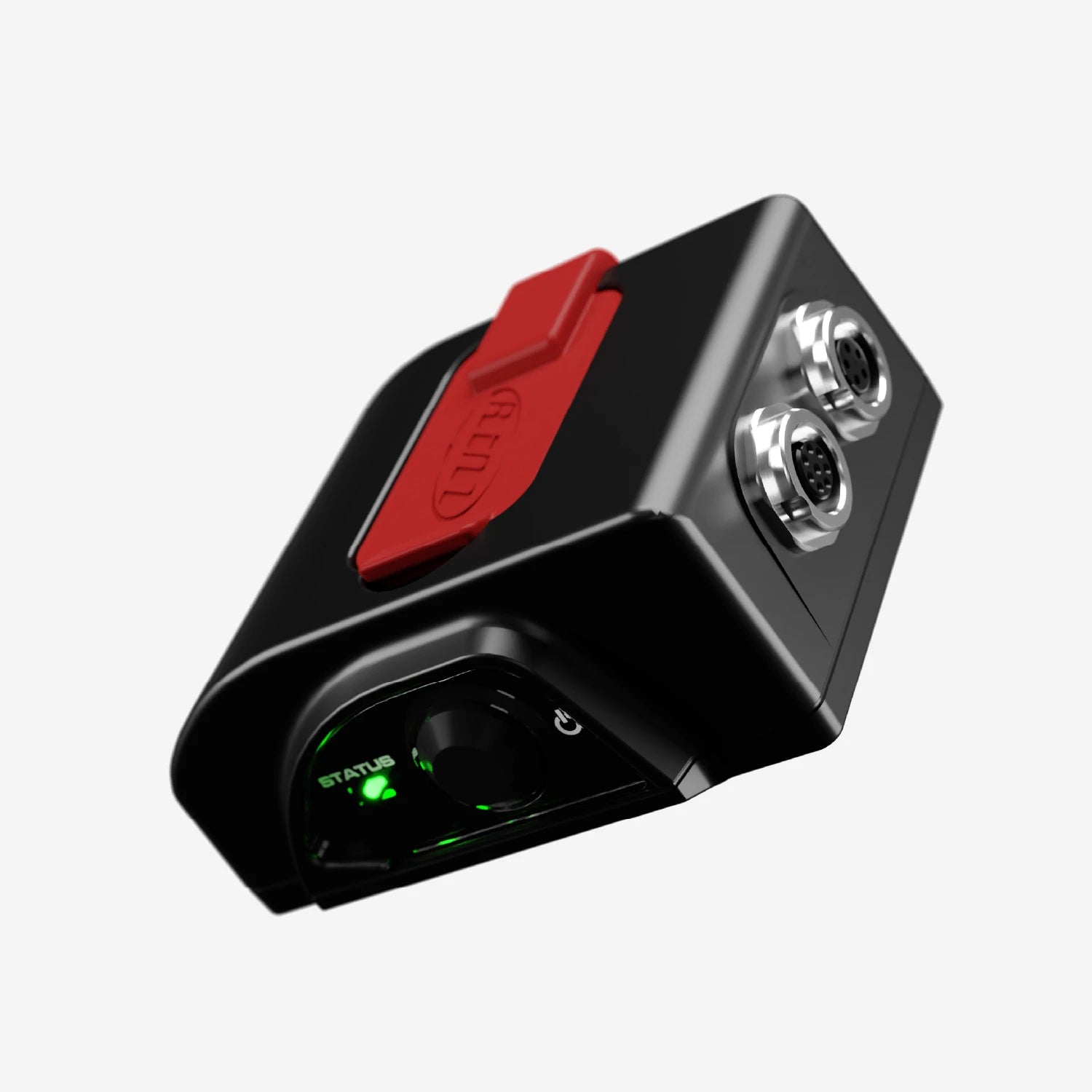

The Aim X Log data logger is essentially a Solo 2 DL without the screen: offering the same logging power, precision, and expandability in a smaller, lighter package. For riders, racers, or anyone working with limited space but still demanding full-scale data analysis, the X Log is the perfect solution.
It provides a powerful solution for anyone who wants to capture and analyse their performance data without needing an on-board display. Combines with the ACC3, Suspension Potentiometers and Brake Pressure Sensors, you will find the ultimate key to control, analysis and improvement.

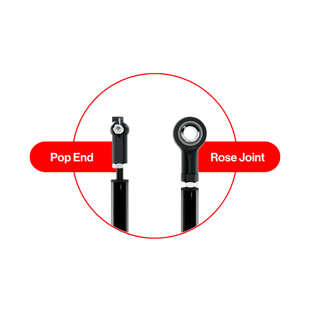

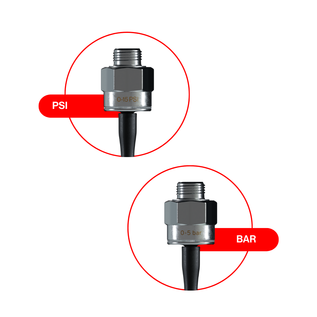

The brake sensor pressure allows you to detect fluid and air pressures. It offers a high level of reliability and endurance and is protected against the high vibration, shock and high temperatures found in motorsport.
These brake pressure sensors are available in a range of sizes as well as PSI and Bar variants.

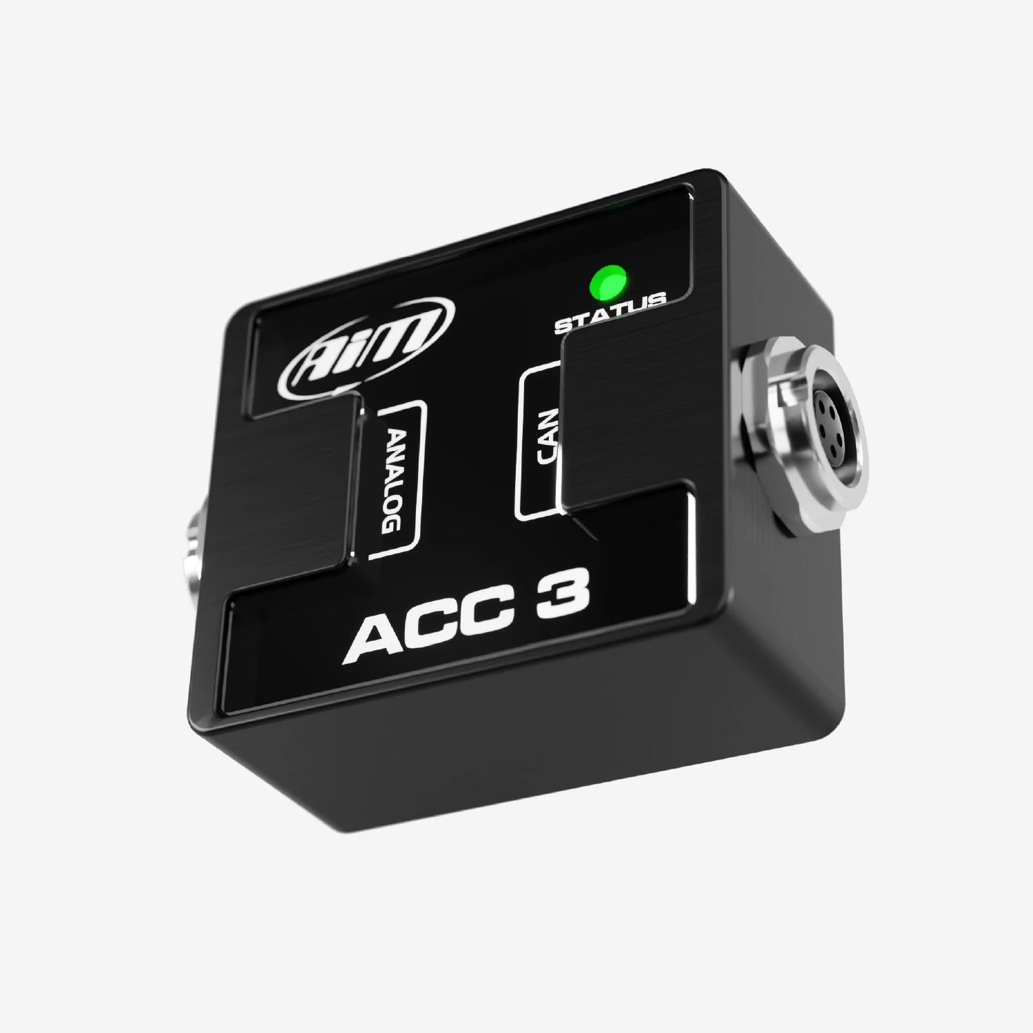

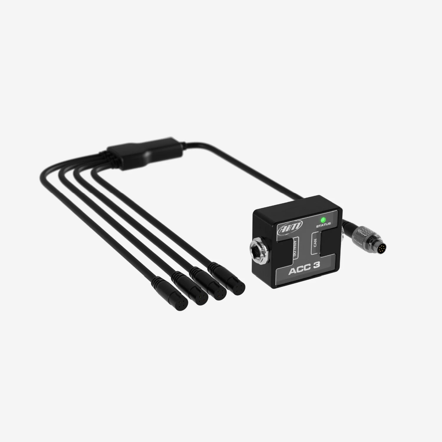

Analogue CAN Converter
Like all Aim devices, the Aim ACC3 is built for motorsport applications. Its compact design ensures easy installation across a range of racing vehicles, while its robust construction guarantees reliability in demanding environments.
Managing up to 4 channels at 200Hz each, the ACC3 allows you to capture and analyse additional sensor data with precision.
When combined with Race Studio 3 software, the ACC3 unlocks powerful configuration and analysis tools, including suspension analysis with Aim Eclipse sensors and video synchronisation with SmartyCam 3 cameras.

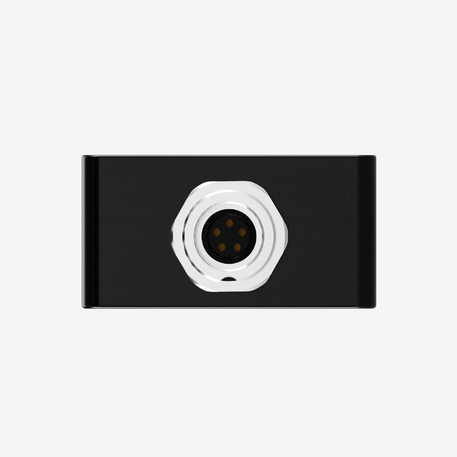

X Log Connectivity
The X Log is designed to connect seamlessly to your vehicle and your data analysis workflow:
- ECU Connection: Supports thousands of predefined CAN, RS232, or K-Line protocols, or you can build your own protocol via CAN builder.
- Second CAN Option: Configure for Aim expansions, or connect additional sensors and third-party CAN devices.
- Wireless: Integrated Wi-Fi and Bluetooth for fast, cable-free data transfer.
- USB-C & Memory Key: 4GB internal memory plus a removable 16GB USB-C key for quick access.

Measuring only 72.3 × 65.3 × 30.3mm, the X Log is compact to fit in even the tightest cockpits. Its rugged, waterproof housing ensures reliable operation in all conditions. With a built-in rechargeable lithium battery (up to 10 hours) and support for an external 8–16V supply, the X Log is built for trackside convenience.

- ACC3 Analogue to CAN Converter: Add up to four analogue channels for pressure, temperature, suspension, and other sensors.
