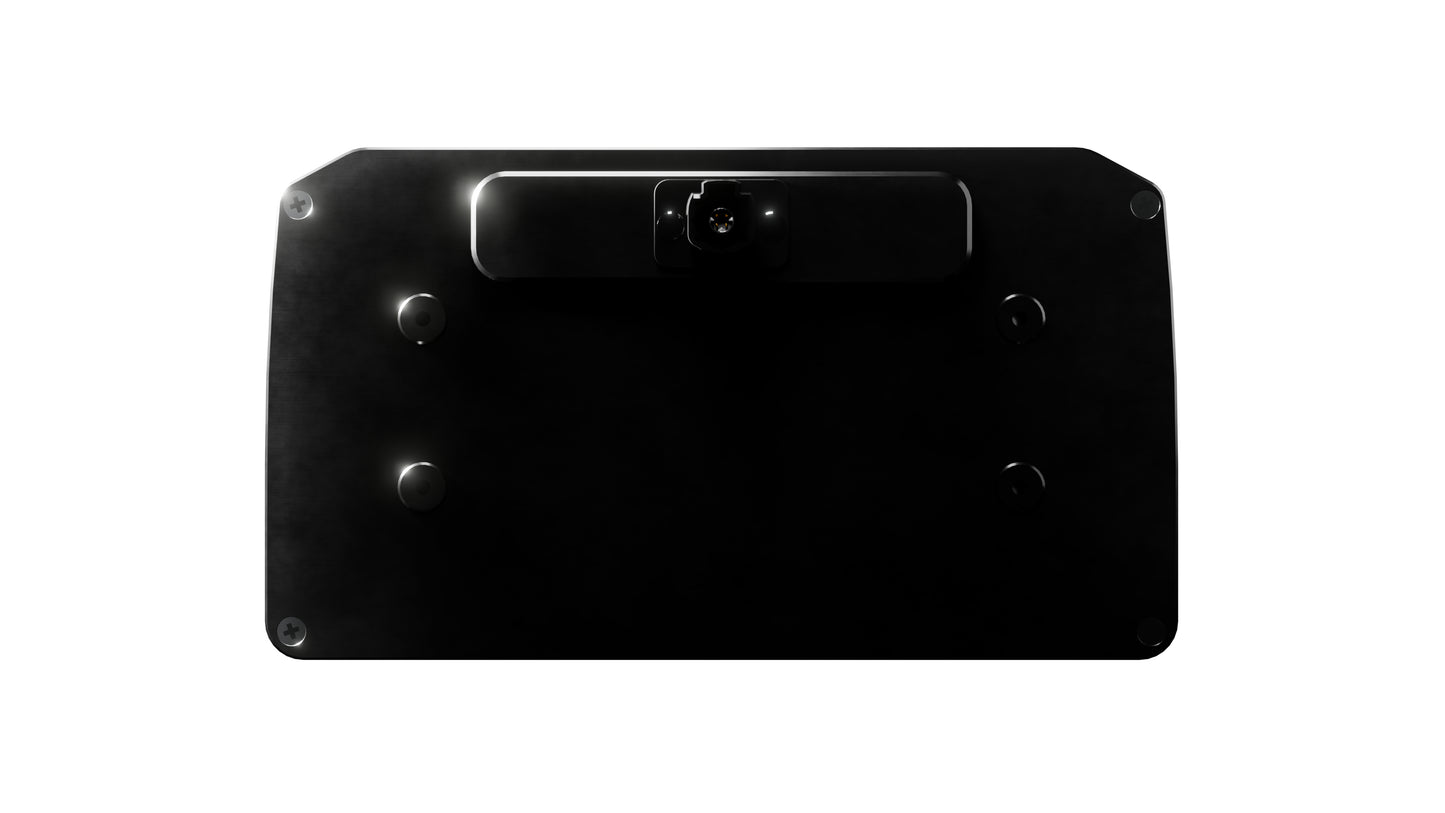

Dash Display 6" Race Icons
6" TFT display Race Icons
Five - Status LEDs Ten - Shift light LEDs
Configurable display Range of layouts
Suitable for replacing all of the dashboard gauges and warning lamps, the TFT dash display is available in 6" or 10" versions and with "Race" or "Road" icons. Both versions have full user-configurable displays and offer a range of layouts.
The display also doubles up as a reversing mirror using a separately available camera—ideal for cars with limited rear vision. You can add up to 2 cameras for both front and rear views. You can find the optional Reversing Mirror Camera in the Accessories Tab.
