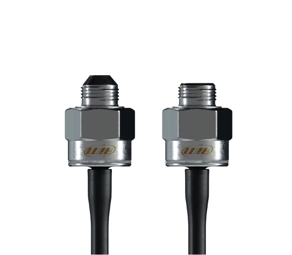

AiM Brake Pressure Sensor M10 0-100 Bar
The AiM M10 0-100 Bar pressure sensor is suitable for oil and fuel pressure readings and can read pressures up to 100 bars. This sensor will monitor brake pressure levels for optimum performance accurately.
M10 -  0-100 Bar 4 pins 719 male binder
The AiM M10 - 0-100 Bar brake pressure sensors are fitted with male four pins black 719 binder plug connections to suit all AIM loggers and dash display/loggers.
Whether your kart is equipped with single, dual, fixed or adjustable master cylinders, adding brake pressure sensors allow you to monitor brake performance, make real changes and identify issues quickly and precisely.
  • Supply: 8-16V
  • Output signal: From 0.5V to 4.5V
  • Characterisation: 500 mV/ 0 bar 4500 mV/ 100 bar
  • Consumption: < 10 mA
  • Sealing: IP66
  • Weight: 30g
  • Cable Length: 400mm
  • Thread: M10
